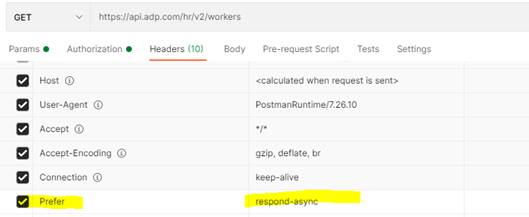

I think I have it.     I can use http_header to get the info for the link field returned in the response header .   The link field is what I need for the next call.
  // tell it we want async processing and get response.........
    callp http_xproc(HTTP_POINT_ADDL_HEADER:%PADDR(AdditionalHeaders));
     rc = http_req('GET': URL: *omit) ;
     If rc = 202 ;
         response = http_header('link') ;
     EndIf;

You'll want to use the http_xproc procedure to register and exit procedure for the HTTP_POINT_ADDL_HEADER exit point.
Then define AdditionalHeaders something like this:
DCL-PROC AdditionalHeaders EXPORT;
DCL-PI *N;
    HeaderData VARCHAR(1024);
    HeaderData = 'Prefer: respond-async' + x'0d25';
    RETURN;
END-PROC;
I've done this many times for additional header fields.  FYI - This how you did bearer tokens prior to the latest version.

I have reached my next roadblock.    The API will only return 100 records unless you tell it that you want to use asynchronous processing.   In postman I have to add a line to the header that says Prefer: respond-async. This will then give a response  in the header that you then use in the next call to fetch the data asynchronously.
How/where do I include the Prefer: respond-async in the header?

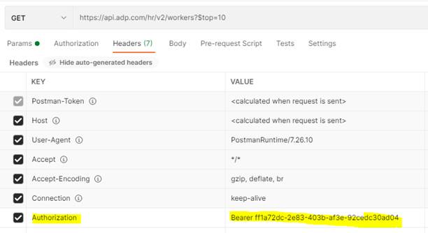

In the current beta version of httpapi (http://www.scottklement.com/httpapi/beta) you can do this:
http_setAuth(HTTP_AUTH_BEARER: '': YourToken);
In older versions you have to build the header yourself using an HTTP_POINT_ADDL_HEADER callback.

I am able to extract the token from the Response variable.   The problem is with the second call.   That token is then used in the second request which makes a GET to return the data stream.  However the second request uses authentication type “Bearer” and I don’t know how to code for that with HTTPAPI.
I can make it work in Postman by pasting the token into the header authorization variable with the word Bearer.    I would appreciate any help you can give on how to pass a bearer token with HTTPAPI.    Thanks!
