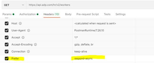

Les,
You'll want to use the http_xproc procedure to register and exit procedure for the HTTP_POINT_ADDL_HEADER exit point.
http_xproc(HTTP_POINT_ADDL_HEADER:%PADDR(AdditionalHeaders));
Then define AdditionalHeaders something like this:
DCL-PROC AdditionalHeaders EXPORT;
DCL-PI *N;
    HeaderData VARCHAR(1024);
    HeaderData = 'Prefer: respond-async' + x'0d25';
    RETURN;
END-PROC;
I've done this many times for additional header fields.  FYI - This how you did bearer tokens prior to the latest version.
Brian

I have reached my next roadblock.    The API will only return 100 records unless you tell it that you want to use asynchronous processing.   In postman I have to add a line to the header that says Prefer: respond-async. This will then give a response  in the header that you then use in the next call to fetch the data asynchronously.
How/where do I include the Prefer: respond-async in the header?
I though perhaps I could include it in the postdata parameter, but that does not seem work.
  // tell it we want async processing and get response.........
    postdata = 'Prefer:respond-async' ;
    response = http_string('GET': URL: postdata: '')  ;

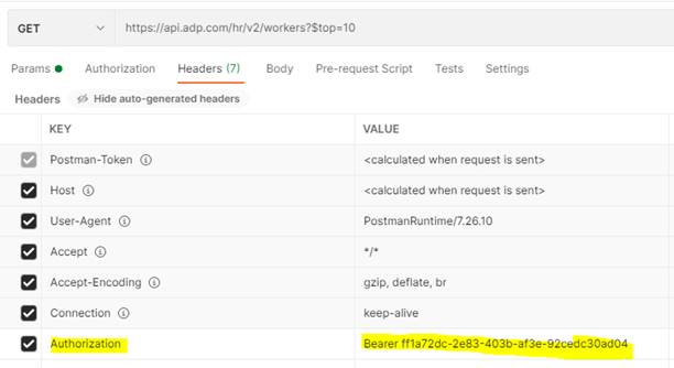

On 4/8/2021 10:28 AM, Les Turner wrote:
I have a requirement to get data from a secure API. It requires a certificate in the DCM, which I have set up.   Then I have to make 2 calls.
The first one is a POST and you use basic authentication to pass a UserID and password to get back a token in the response body.   This is working with this code:
    // Open persistent connection
    pComm = http_persist_open(URL);
    // Set credentials
    http_setauth(HTTP_AUTH_BASIC: username: passwd);
   // use the certificate in the DCM
     app_id = 'ADP_APPLICATION';
     rc = https_init(app_id);
     if rc = -1;
        http_comp(http_error());
        https_cleanup();
    response = http_string('POST': URL: postdata: 'application/json')  ;
I am able to extract the token from the Response variable.   The problem is with the second call.   That token is then used in the second request which makes a GET to return the data stream.  However the second request uses authentication type “Bearer” and I don’t know how to code for that with HTTPAPI.
I can make it work in Postman by pasting the token into the header authorization variable with the word Bearer.    I would appreciate any help you can give on how to pass a bearer token with HTTPAPI.    Thanks!
