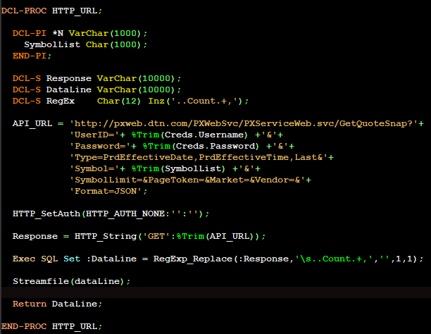

You’re exactly right I just limited the amount of “symbols” I process and it worked fine, thank you for looking into!

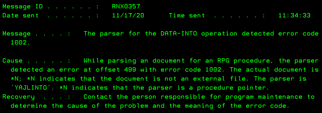

I'm afraid it's staring us right in the face, and we have been looking at the wrong things.  HTTP_URL returns 1000 characters. You define RESPONSE and DATALINE as 10000. You get your response, run in through the regex into dataline. Write that to IFS, and then return the first 1000 characters.

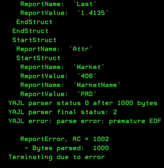

So parses it okay until it gets to here, I’ve attached an excel copy of the output with length on all the lines so you can see exactly where its stops (if that helps at all)….

Can you try adding this somewhere and see what the output looks like?
ADDENVVAR ENVVAR(QIBM_RPG_DATA_INTO_TRACE_PARSER) VALUE(*STDOUT)

I keep getting an odd error code and I cant determine what I’m doing wrong, here is the code to get the data:
I send the DataLine to an IFS file so I can capture the output of the regular _expression_ just to visualize what I’m getting, regarding the regular _expression_ I have do this in order to parse the JSON file and this works just fine if I capture the file into an IFS file then use Grep to remove the part of the JSON that causes the error, however when I capture just the output to a variable is when the error occurs, I have a feeling its being caused by the regular _expression_ however the DataLine variable looks identical to the file I produce using Grep.
This is where the error occurs:
Thoughts?
