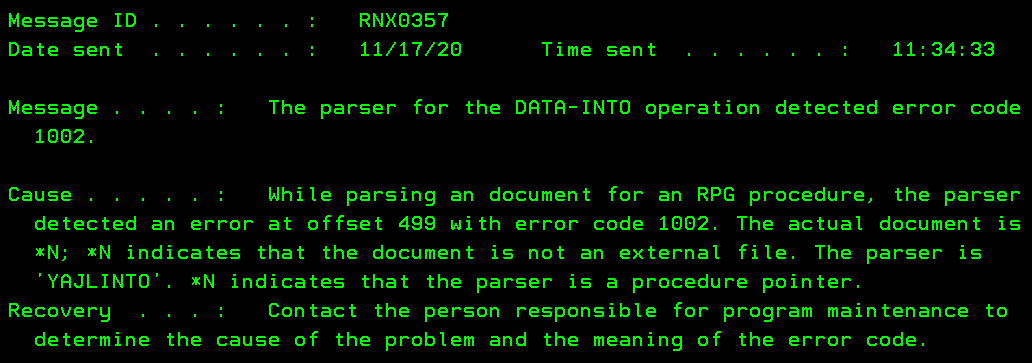

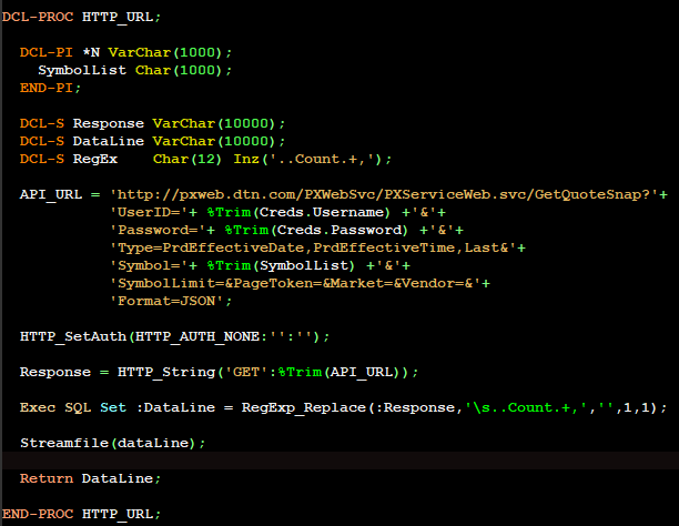

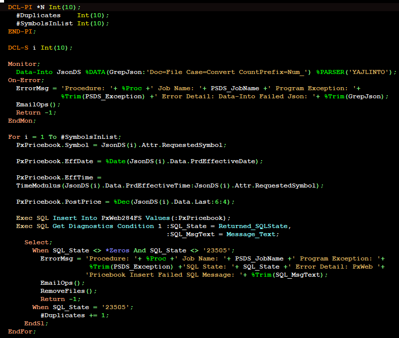

I keep getting an odd error code and I cant determine what I’m doing wrong, here is the code to get the data:

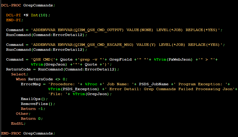

I send the DataLine to an IFS file so I can capture the output of the regular _expression_ just to visualize what I’m getting, regarding the regular _expression_ I have do this in order to parse the JSON file and this works just fine if I capture the file into an IFS file then use Grep to remove the part of the JSON that causes the error, however when I capture just the output to a variable is when the error occurs, I have a feeling its being caused by the regular _expression_ however the DataLine variable looks identical to the file I produce using Grep.

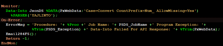

This is where the error occurs:
Thoughts?
Keeping in mind this works….
