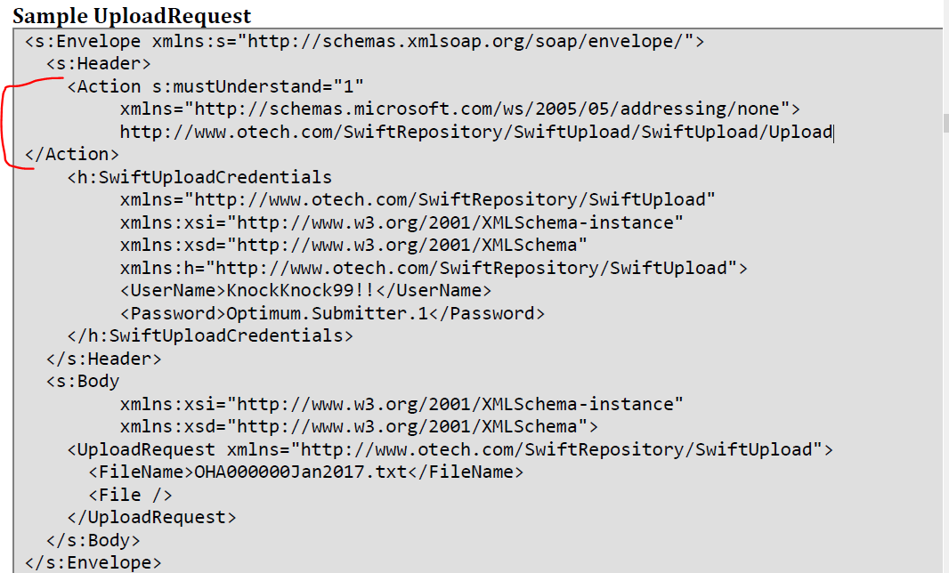

Try letting HTTPAPI set the soap action for you. Remove the <Action></Action> section and before you run your request do this:
rc = http_setOption('soap-action':'http://www.otech.com/SwiftRepository/SwiftUpload/SwiftUpload/Upload');

Indeed, the DOJ had not provided us a complete URL for the service.  We got that, so we are over that hump.  Now I am dealing with other issues.
The SOAP envelope is confusing me.  If I omit the "<Action> tag in the envelope, I get an HTTP 500 Error.  If I include that tag formatted as it is shown in their example, I get an HTTP 400 error.  I have tried every which way I can think of to format this differently, without success.  I am suspecting there is something else I need to do with HTTPAPI to get this to work.  I see things in the service program related to "SOAPAction", and I am wondering if this is something I need to set.
I even downloaded the WDSL ( https://catraining.nibrs.com/SwiftUpload.svc?wsdl ) into SoapUI and it neatly unpacked all the methods.  Their soap envelope was much simpler than the documentation provided by the client, which is seen below:
  I have attached logs and the program source.
