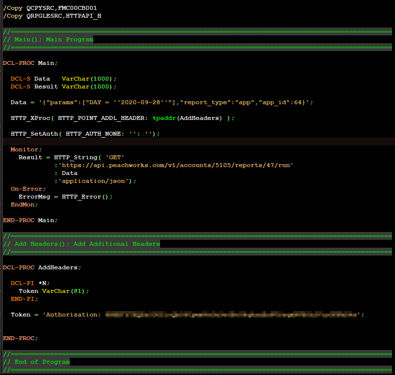

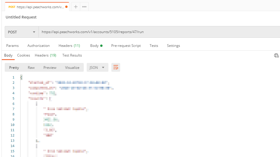

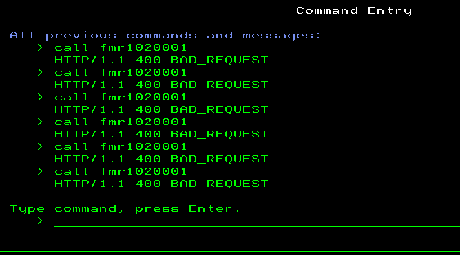

Well so far I can get it to work with curl in QSH and with Postman, but not with HTTPAPI, attached is the script.

First screen capture is when I run HTTPAPI that isn’t working:
Postman worked out:

Thanks Scott, the only problem I’m having is http_string doesn’t seem to be defined anywhere, perhaps I’m missing something?
**FREE
// Copybooks -
/Copy QCPYSRC,FMC00CB001
/Copy QRPGLESRC,HTTPAPI_H
// Main(); Main Program
DCL-PROC Main;
  DCL-S Data   VarChar(1000);
  DCL-S Result VarChar(1000);
  Data = '{"params":["DAY = ''2020-09-28''"],"report_type":"app","app_id":64}';
  HTTP_XProc( HTTP_POINT_ADDL_HEADER: %paddr(AddHeaders) );
  HTTP_SetAuth( HTTP_AUTH_NONE: '': '');
  Monitor;
    Result = HTTP_String( 'GET'
             :'https://api.peachworks.com/v1/accounts/5105/reports/47/run'
             : Data
             :'application/json');
  On-Error;
    ErrorMsg = HTTP_Error();
  EndMon;
END-PROC Main;
// Add Headers(); Add Additional Headers
DCL-PROC AddHeaders;
  DCL-PI *N;
    Token VarChar(81);
  END-PI;
  Token = 'Authorization: ';
END-PROC;
// End of Program
