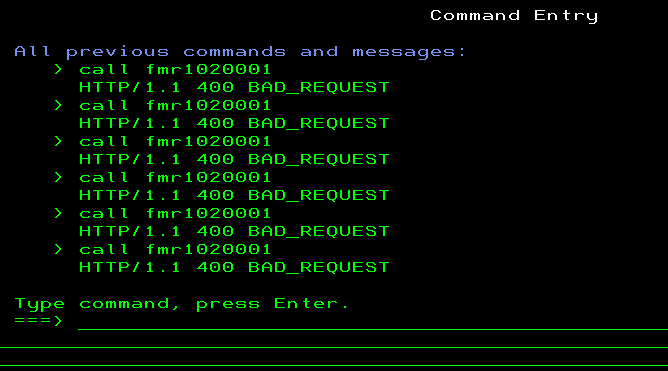

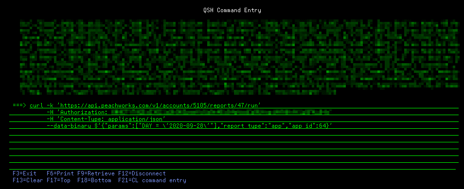

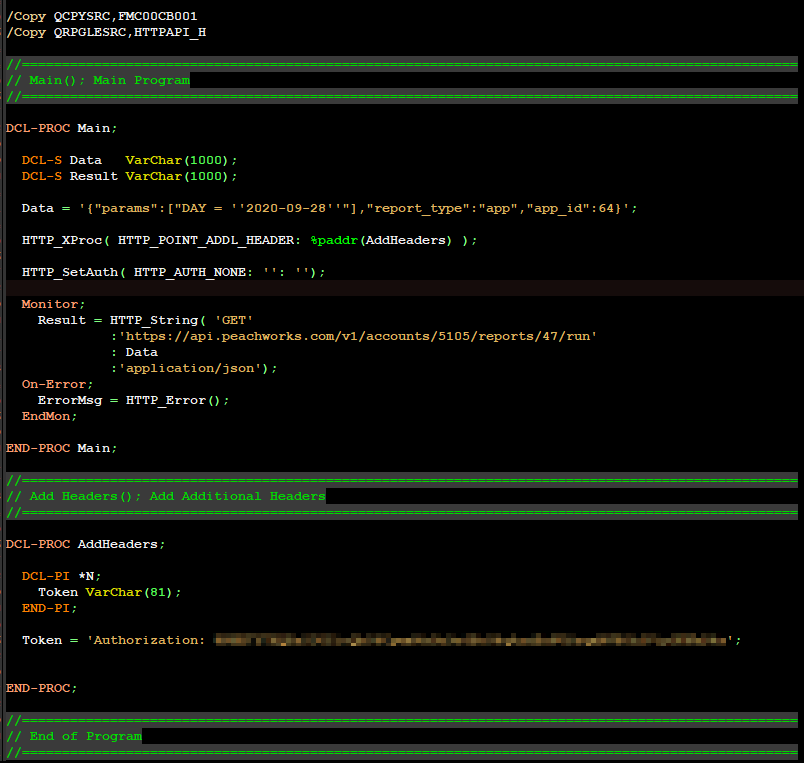

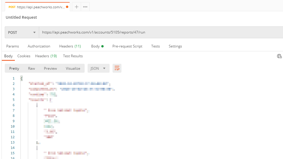

Well so far I can get it to work with curl in QSH and with Postman, but not with HTTPAPI, attached is the script.
Scott if you’d like the actual access token let me know I don’t feel comfortable sending it to a mailing list.
I figured out also that I really didn’t need all those additional headers it was just overkill as you pointed out.
Any advice you can offer would help.
First screen capture is when I run HTTPAPI that isn’t working:
Postman worked out:
curl via QSH worked as well:
RDi Screenshot:

Thanks Scott, the only problem I’m having is http_string doesn’t seem to be defined anywhere, perhaps I’m missing something?
