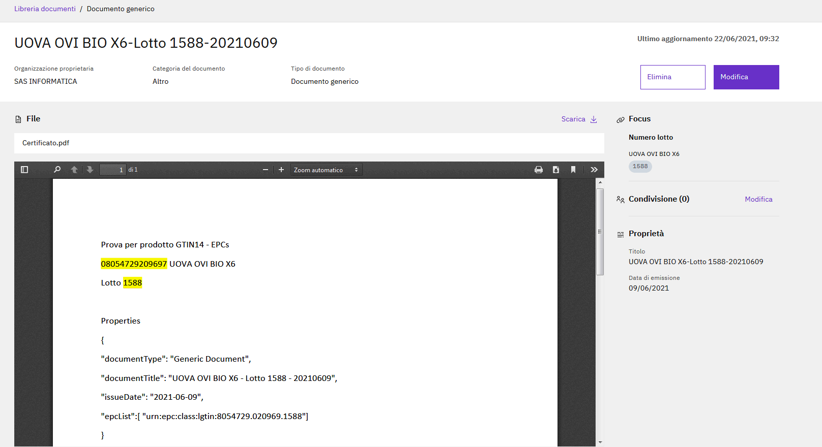

This is a document sent with another procedure, called swagger.
And this have the PDF attached as you see.

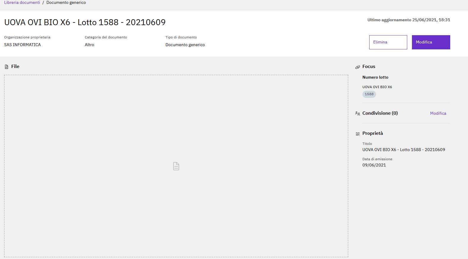

And this one instead, sent with my RPG program doesn't have the PDF attached:

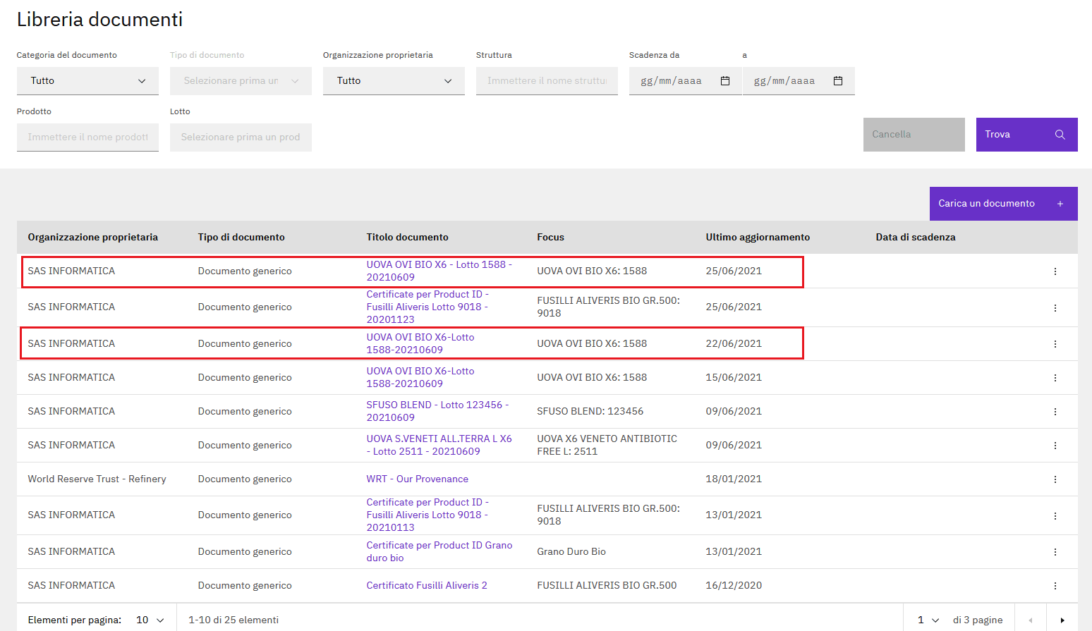

But in the document library there are both document  listed.
