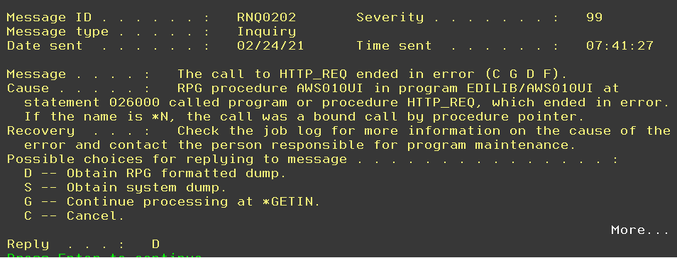

On 2/24/2021 10:46 AM, Anthony Shrader wrote:
I recently started consuming several AWS api’s and I’m getting an error I’ve never seen before. I can’t seem to recreate the error and it always seems to happen in a different area of the process.
I was able to narrow it down a little further by running in debug. It breaks in COMMTCPR4 at this procedure…
P CommTCP_FD_SET...
P                 B                   EXPORT
D CommTCP_FD_SET...
D                 PI
D   peFD                        10I 0
D   peFDSet                           like(fdset)
D wkByteNo        S              5I 0
D wkMask          S              1A
D wkByte          S              1A
C                   callp     CalcBitPos(peFD:wkByteNo:wkMask)
c                   eval      wkByte = %subst(peFDSet:wkByteNo:1)
c                   biton     wkMask        wkByte
c                   eval      %subst(peFDSet:wkByteNo:1) = wkByte
P                 E
wkByteNo turns out to be 32.
It makes sense because peFDSet is only 28 bytes.
I’ve re-run the same request immediately after this error and it works just fine. If I happened to be running it interactively I have to sign-off then sign back on first.
We’ve considered increasing the length of the fdset variable in LIBHTTP/PRIVATE_H but there are so many procedures referencing it. I don’t want to rock the boat.
I also have a hard time believing that the variable in the copybook needs to be changed. It HAS to be something I’m doing right?
The only real difference I can spot is that this new AWS stuff requires a lot more http requests per process than any other web service we use. We’re talking 3-4 times more. Could the amount of requests in a job be related?
