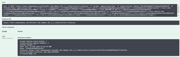

This is my first program using http_req to call an API.  I successfully get the request written to the database, but I am not getting the "response" variable with a value.  "httpResponse" is coming back with "1".  "response" is empty.  I am including my code, log from running the program, and a copy of what happens when I run my json statement via a curl command.  In the "Response headers" of curl is a line for "location:".  I need to be able to retrieve the value after "/schools/".  This is my record id that I need if I want to delete the record or be able to just get that one record.  I can see this line in my log file also, so I know it is somehow getting returned, but I don't see it in the response field.

CURL response:
