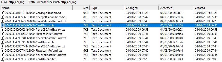

Try and change the debug level setting. Add this right after your http_debug call.
http_setOption('debug-level':'2');
