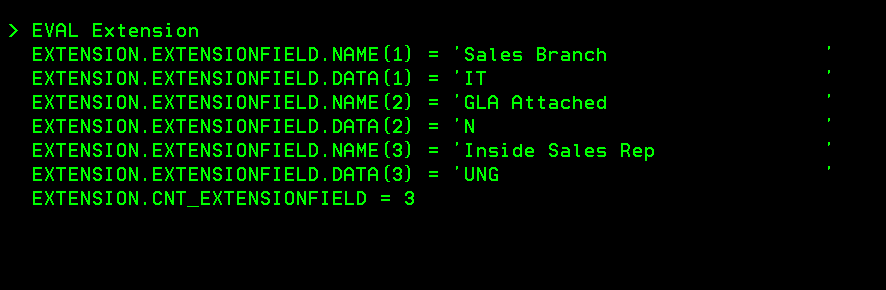

here is the solution
         ctl-opt main(main) dftactgrp(*no) option(*nounref);
      // Example with datasubf=data                                       //
      // R.Ross 01.2020 *                                                 //
      // Array XML-File                                                   //
         dcl-ds  Extension             qualified inz;
                  ExtensionField       likeds(ExtensionField) dim(3);
                  cnt_ExtensionField   uns(10);
         end-ds;
         dcl-ds  ExtensionField        qualified;
                  Name                 char(30);
                  Data                 char(30);
         end-ds;
      // Main                                                             //
         dcl-proc main;
         dcl-s   LocData     varchar(1000);
         dcl-s   LocOpt      varchar(256);
           LocOpt = 'doc=string +
                     case=any allowextra=yes +
                     countprefix=cnt_ +
                     datasubf=data +
                     allowmissing=yes';               // XML-Options
           LocData =
            '<Extension extensionTemplate="PARTNER_HEADER">' +
             '<ExtensionField name="Sales Branch">IT</ExtensionField>' +
             '<ExtensionField name="GLA Attached">N</ExtensionField>' +
             '<ExtensionField name="Inside Sales Rep">UNG</ExtensionField>' +
            '</Extension>';
           xml-into Extension %xml(LocData:LocOpt);
         end-proc;
and the debugview
