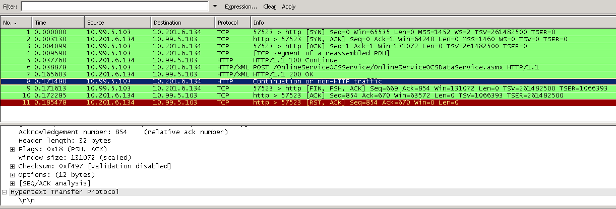

   It looks like the problem is different than we first thought.
   Apparently, this is how it goes:
   1) request van iSeries to webservice -> this works fine
   2) reply from webservice to iSeries -> returns the expected result
   BUT then:
   3) another message is sent from iSeries to the webservice:
   This causes the bad request.
   So the initial call turns out to be just fine.  Looks like it's
   something else...
   I've included a screenshot that shows what is happening (numbers 6, 7
   and 8) (you see the content of the bad request on the bottom of the
   screenshot)
   kind regards,
   Ruben

   > Hi Ruben,
   > What problem am I trying to spot? What is going wrong?
   > I'm looking at your request, and I'm not familiar with the format of
   the
   > trace file that you've sent, but it appears that the HTTPAPI request
   > looks like this (please forgive any line-wrapping)
   > POST /onlineserviceocsservice/onlineserviceocsdataservice.asmx
   > HTTP/1.1\r\n
   > Host: oos-tst.oce.net\r\n
   > User-Agent: http-api/1.20\r\n
   > Content-Type: text/xml\r\n
   > SOAPAction: http://oosocsservice.oce.com/GetMachineCNTData\r\n
   > Expect: 100-continue\r\n
   > Content-Length: 414\r\n
   > \r\n
   > And the successful (non-HTTPAPI) session looks like this:
   > HTTP/1.1\r\n
   > User-Agent: Mozilla/4.0 (compatible; MSIE 6.0; MS Web Services Client
   > Protocol 4.0.30319.239)\r\n
   > Content-Type: text/xml; charset=utf-8\r\n
   > Content-Length: 406\r\n
   > Expext: 100-continue\r\n
   > Connection: Keep-Alive\r\n
   > \r\n
   > To know which difference might be relevant, I need to know what the
   > problem is. But, the following differences might cause an issue
   > (depending on the problem)
   > 1) User-Agent. Some sites only allow certain user agents... Are you
   > getting an error saying "Only Internet Explorer is allowed" or
   something
   > like that?
   > 2) The charset on the content-type. You aren't specifying a character
   > set, but they have specified utf-8. Are you getting an error with
   > unrecognized character set? OR a problem with characters being
   > mistranlated?
   > 3) Content-length... they are sending 408 bytes, but you are sending
   > 414. That means the data you're sending is different from theirs. I
   > don't know that the difference is, or what error you're receiving, so
   > it's hard to say if the extra 6 bytes you're sending might be causing
   > the problem?
   > All of three of these values are controlled by the parameters you
   pass
   > to HTTPAPI. User-Agent and Content-Type are parameters to
   > http_url_post_xml (I'm assuming that's the API you're calling,
   because
   > you made it the subject of the e-mail.) Content-length is simply the
   > length of the postData you've sent.
   > This sure would be easier if I knew what problem you are
   experiencing.
