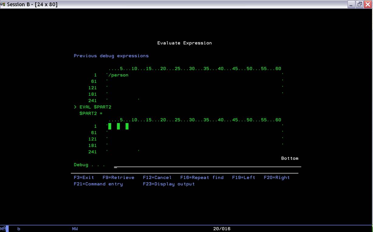

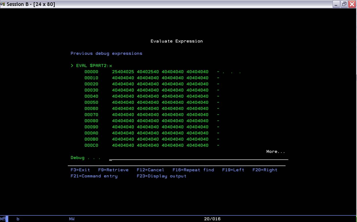

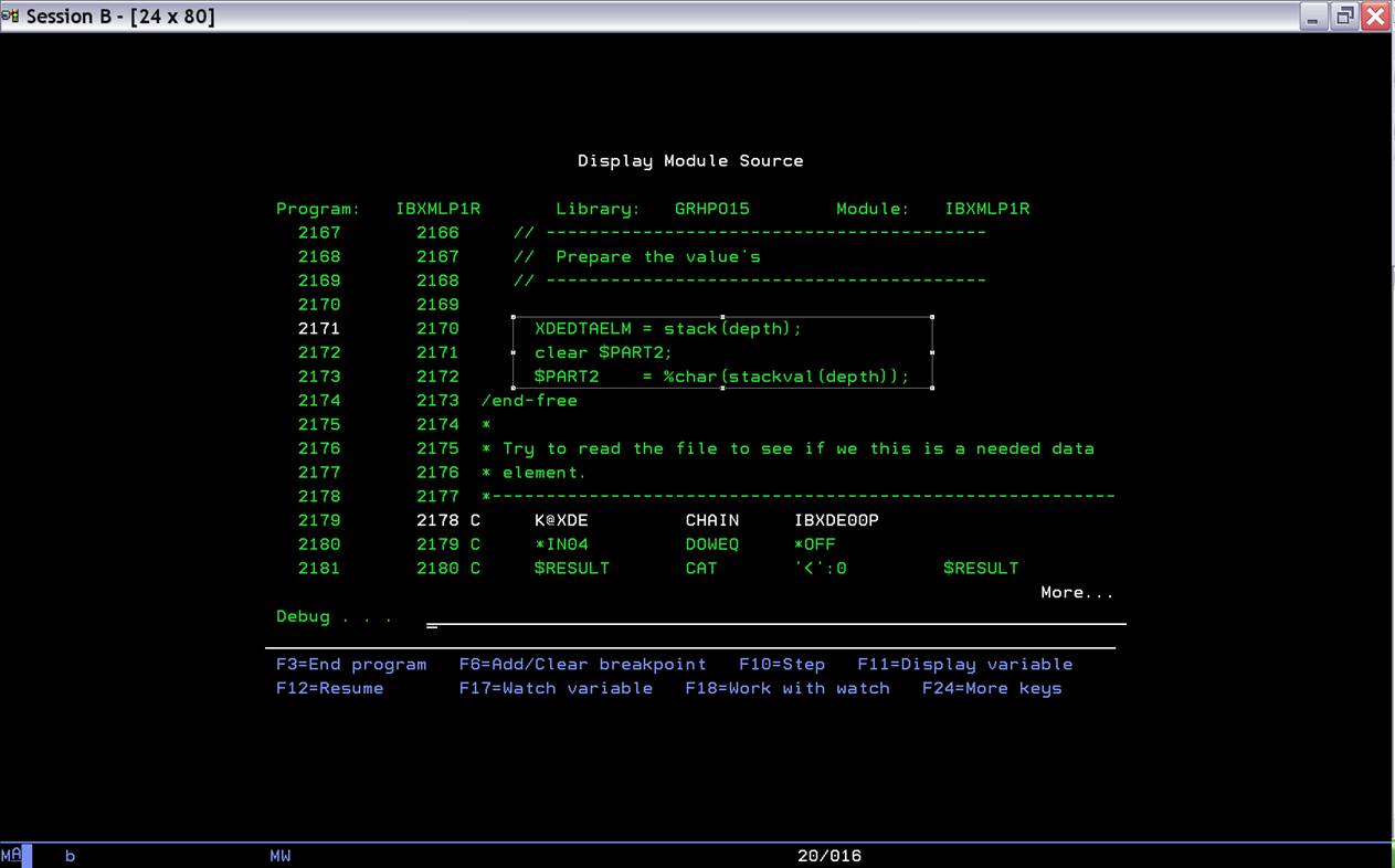

   Thank you for the tip, I did a debug on the EXAMPLE15 program as you
   indicated in your reply.
   Indeed I did not make use of the "attrib" parameter as yet.
   I have adapted our own program and tested it with success.
   Thank you,

   Hi Hendrik
   You try EXAMPLE15 of HTTPAPI LIB  ??
   You should have an "attrib" parameter in your parser handler ...
   Regards
   Nicolas

   Dear all,
   We are having difficulties to extract data from XML attributes with
   eXpat on the iSeries.
   The XML Elements are going fine.
   see: [3]http://www.w3schools.com/xml/xml_attributes.asp
XML Elements vs. Attributes
   Take a look at these examples:
   <person sex="female">
     <firstname>Anna</firstname>
     <lastname>Smith</lastname>
   </person>
   <person>
     <sex>female</sex>
   </person>
   In the first example sex is an attribute. In the last, sex is an
   element. Both examples provide the same information.
   There are no rules about when to use attributes and when to use
   elements. Attributes are handy in HTML. In XML my advice is to avoid
   them. Use elements instead.
   When I pass this via Xpath I get the results:
   /person/firstname           Anna
   /person/lastname           Smith
   /person                        (something unreadable, hex25 - blank -
   blank -hex25 - blank - blank - hex25)
   How can we get the "sex" information from this example?
